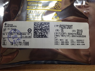

Dears,
... in our new project design we used the chip _B_Q25672,
but we receive the chip with mark _P_Q25672.
What is difference between its?
Many Thanks

Hi Milan,
The PG25672 is the pre-production, APL version of the silicon. It has most of the final IC functionality but not MPPT and the poor source circuit works slightly differently. When did you receive this? Those ICs should have been purged from PDC last year.
Jeff
