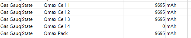

Please check to  below.
1. I'm going to use the cell as a 3S2P. Do I have to fill out the below based on 3S2P?
2. Will the items in LIFETIMES be updated during charging/discharging?
3. Should I fill out the cell's capacity for the item below?
