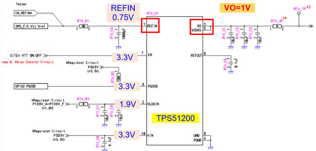

A problem occurs using TPS51200.
The input to the TPS51200 is as follows.
・ REFIN 0.75V
・ EN pin 3.3V
・ PGOOG pin 3.3V
・ VIN pin 3.3V
The desired output voltage is 0.75V. After mounting on PCB, 0.75V is output normally. However, the output voltage changes to 1.0V at a certain timing. If you have any advice on the cause of this phenomenon, please let me know.

    REFOUT pin = 1V. There is no change in REFIN and VLDOIN.
    Would you be able to attach a copy of your schematic so that we can review it and see if there is anything that could indicate why this issue occurs?
    The circuit diagram is shown below.

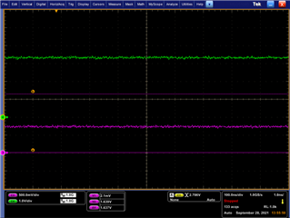

    Are you able to capture measurements at the device pins for the following two setups at startup:
    1. VIN, VLDOIN, EN, & REFIN
    2. EN, REFIN, REFOUT, VOUT
    It seems unusual that REFOUT and VOUT would be at 1V without REFIN also being at 1V, considering that REFOUT is just the output of a voltage follower with REFIN as the input - REFOUT should always be incredibly close to REFIN.
    Do you happen to know if this increase to 1V is gradual, or sharp? My theories are either here is some damage to the actual IC, or REFIN is not stable.
    Kadeem
  • HI, Kadeem
    Sorry for the late reply.
    ■The images below are about REFIN and EN.
    - Purple waveform: REFIN
    - Green waveform: EN
    ■The images below are about VLDOIN and VIN.
    - Blue waveform: VLDOIN
    - Purple waveform: VIN

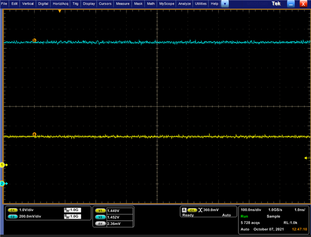

    ■The images below are about VO and REFOUT.
    - Yellow waveform: VO
    - Blue waveform: REFOUT
    I wanted to take a waveform with VOUT rising to 1V and sticking, but our product that occurred has been repaired and is in a normal state.
    Instead, we acquired the waveform of "VOUT rises to about 0.84V and sticks (expected value: 0.75V)", which is a relatively close phenomenon.
    The timing when the VOUT rise is seen is continuous from the time of startup to the time of device shutdown. Therefore, the above voltage waveform is the same.

    There is one thing that I would like to try, if you can. Are you able to depop R3 and connect VLDOIN to CN_REFIN, and see if you still see this issue? I do not believe that I have seen many, if any, applications where VLDOIN is different than the input to the REFIN divider, and I am wondering if this may have something to do with the issue that you are seeing.
    I will see if I can replicate this issue on the EVM. What is unusual is that REFOUT would also be 1V, since it is just a voltage follower op-amp between REFIN and REFOUT.

  • Hi, Kadeem
    I connected VLDOIN and REFIN. And when operated with REFIN = 0.75V, VOUT was 1.45V.
    Also, when operating at REFIN = 1.7V, the VOUT was 1.65V.
    After connecting VLDOIN and REFIN, turn on the power with REFIN = 0.75V.
    I lowered the voltage of REFIN to 0V while it was running. Then, VOUT = 1.45V did not drop.
    When the power was turned on with REFIN = 0V with the same connection, VOUT = 0V.
