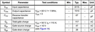

1)Gate driver capability to Drive the Mosfet's(3 in parallel)
2)Boostrap Diode Voltage rating
3) You recommend to use Zener diode at LO & HO Pin
System Parameter
System Voltage :60V
Vgs: 12V
MOSFET Parameters attached the Image
No of MOSFET Parallel:3
targeting Raise time:500ns
Fsw:20khz
PFA of mosfet Data

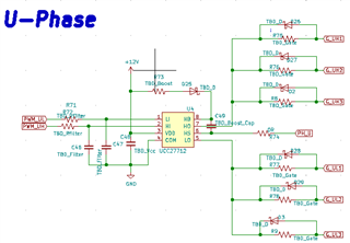

And gate Driver Schematic

    If I understand correctly, you will have 3 MOSFETS in parallel on both high and low side for 6 total? To drive 3 in parallel, the gate charge is 117nc*3, which is 351nc. Divide this by the rise time (500ns) to get an estimate of the drive strength needed. In your case 351/500 = 0.7A. The part you selected is rated for 1.8A sourcing, which is above minimum and should be okay. Also, you should be careful that your FETs have the same the same trace length and width from the driver in order to ensure they turn on/off at the same time.

    In the worst case, your bootstrap diode should be able to handle a reverse DC voltage of your Vbus(the voltage on the drain of your high-side FET) + VDD voltage. I am a little confused by the naming conventions you used, but if your system voltage(60V) is Vbus, and Vgs is VDD, you need at least 72V. However, you should double check that we are referring to the same voltages. Also, you should go above that number to handle transients and make your system more robust.
    Unfortunately, I am confused by this one. In your diagram, you have what I believe are Schottky diodes on LO and HO, not Zener diodes. Zener diodes are sometimes used to create a negative voltage for driving SICFETs, but I don't know if that is what you are referring to. The purpose of those Schottky diodes is to allow the FET to sink current through that path rather than through the gate resistor. If you are referring to clamping negative voltage on the switch node, that is also usually done with a Schottky diode.
