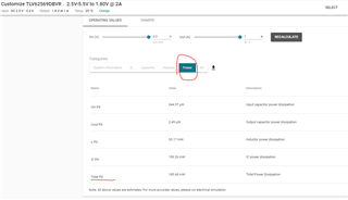

Hi Farheen
The operating conditions as below.
Many thanks
Denny
Hi Denny,
According to my calculation with your operating conditions but with the schematic available on Webench tool:
Tcmax @2A,1.5V =148.56°C , Pd @25 degrees=653.36mW
Tcmax @1A,1.8V =149.59°C, Pd@25 degrees=185.09mW
Used Schematic:
In case you want to calculate with your schematic, I will recommend to use Webench Power designer tool from TI to get the power dissipation data under your operating conditions. You can edit the schematic and analyze the Pd data.
and to calculate the Tc, you can have a look at following paper.
