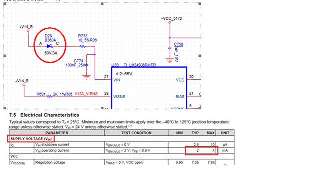

Hi
D28 you need to add the schematic?
Hi Gareth,
thanks for posting on E2E forum.
See below excerpt from the Datasheet which should answer your question:

Hi Gareth,
if Vin is always greater the Vcc the Diode is not required. It only has the function to avoid current flowing back to the source as this is not prevented by the internal circuit of the LM34936.
