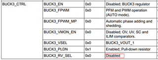

1. in PDN-0B, FB3 is used to monitor the VDDS_DDR. However, in SLVC32, the default NVM setting is to disable this feature(BUCK3_RV_SEL and BUCK3_VMON_EN). Which one is correct?

        There are two components.  The static settings which are copied from the NVM to the user registers during boot and then the sequences which change the user registers based upon a trigger.  Please note that all regulators and monitors are off in the static settings and these are turned on in a specific order as described in the power sequences.  https://www.ti.com/lit/ug/slvuc32/slvuc32.pdf#page=42
        Thank you for the feedback.  We will work to make the checklist more clear.  If unused then it should be connected to ground.  The datasheet will always be the definitive specification.

        We do not.  In most cases the rails are are enabled/disabled or the IO is changed from high or low.  This is not the case in the ACTIVE_TO_WARM and MCU_TO_WARM where the voltages are restored to the static NVM value.  Please let me know if this is not clear.

        We do not have a summary for the registers in every state.  Please remember the values stored in the NVM are written into the user registers after power up and the PFSM sequences also write to the user registers when triggered.
        After Power On and before ENABLE pin on PMICA goes high:
    • FIRST_STARTUP_DONE=1
    • Disable all residual voltage checking: BUCK1_RV_SEL=0, BUCKx_RV_SEL=LDOx_RV_SEL=0
      ENABLE pin goes high on PMICA (valid on request)
    Chris
