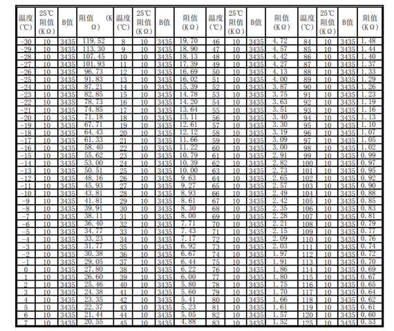

    The value of the thermistor at 45C is 4.88X10^3Ω;
    In this case, the voltage on the TS pin is 1.48V.
    The NTC SPEC as below:
    Star.

    Also, with a TS of 1.48 V, the TS percentage of VDRV is 28.5%. The hot battery threshold is 30% of VDRV. At the provided TS voltage the charger will suspend charge.
