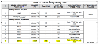

Hi Amod,
Here is their configuration
Thank you and best regards,
Michiaki

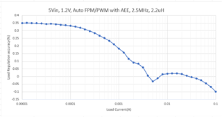

For Load regulation, we only have 5Vin, 1.2V/0A-100mA curve as below. We don't have 2.5V/64mA test data available. But it should be similar to 1.2V.

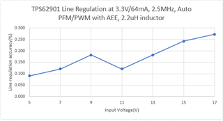

For line regulation, we only have 3.3V test data as below. 1.2V and 2.5V should have similar performance.
