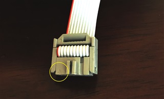

What is the physical pinout of the connector on the HPA172 USB-TO-GPIO? I can only locate the signal pinout list, but there's no indication of where pin 1 or 2 is on the connector.

You can find the pinout in the EVM user guide here. Pin 1 is very faintly marked with a triangle on the connector. I posted a photo below, and manipulated the colors to make it more obvious.
Thanks. Do you know if pin 2 is next to pin 1 in the same row, or under it on the next row?
