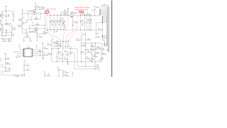

Why my TPS24713 can only carry 1A loads, in my diagram, PIN 10 and PIN are suspension, do they have any impact on the outputs?
thank you!

Thanks for reaching out to us. However, I'm unable to understand your query. Please explain in details and share the complete schematic of TPS24713 in a single picture

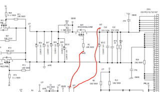

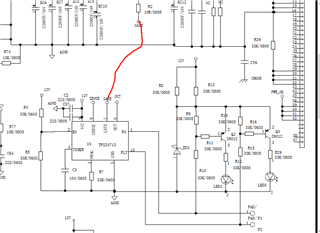

Hello Avishek,
I attached a new diagram, I want to know why input is 17A but output is 1A, if I need to adjust pin1 and pin10 parameters?
thank you!
Thanks for sharing the schematic. I will go through it and will get back to you on Monday. Tomorrow is our holiday.
May I know what's the sense point to measure the current at "OUT" node? Please indicate in the schematic. There might be some leakage at "12V" or "OUT" net, because of which Hot Swap output is at 12 V, 1 A although input is at 12 V, 17 A. As the "OUT" net is at 12 V, TPS24713 is working fine. In order to confirm that the LED indication circuitry on "PG" and "FLT" pins are causing the issue, please make these two pins floating and see what's the voltage and current at "OUT" node.
