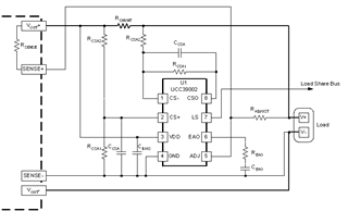

May we know what is the purpose Rsense inside the module? Customer used the calculator and found out if they changed Rsense to zero and error will show. Thanks a lot!

the Rsense is placed in series with resistor divider on output voltage sampling of the module.
if customer do not know the resistor, you can set a resistor as big as possible.

Thanks for your reply! May we know what is the suggest resistor for as big as possible? Thanks a lot!!

since The Rsense is in parallel with Radj in the system, a bigger Rsense will have less influence on Radj calculation.
usually I would use Mohm resistor for Rsense calculation.
and if you use a small value of Rsense, please make sure you add the correct Rsense in the calculator.
you can refer to below setting up the load share controller and Rsense/Radj.
