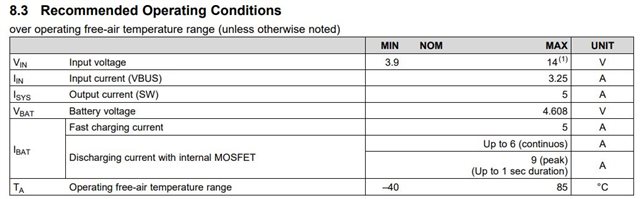

My customer is testing TAS5825P as a load, then inrush current IBAT is over 9A (below 10A) for few milliseconds. It exceeds the recommended operating conditions, is that no problem? If it has an absolute maximum rating, please let me know.
Additionally they tested TAS5825P with BQ25883 as well, but BQ25883 accepts IBAT<9A up to 1us per datasheet. It is 1s at BQ25890 but is it really "1us" at BQ25883?
