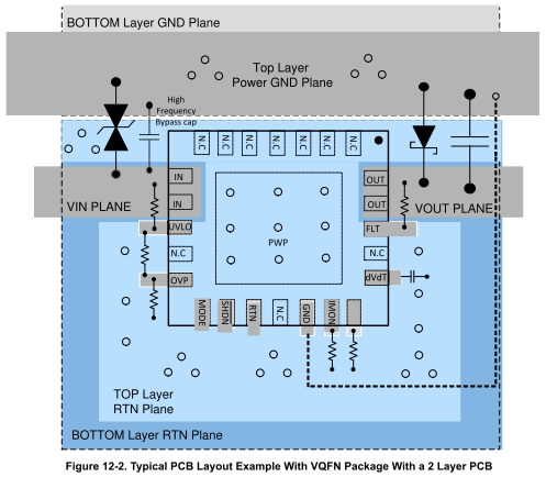

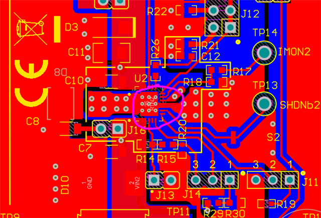

Hello team,
Layout of the data sheet has Through-Hole on bottom layer. On the other hand, EVM layout does not have it.
Which is the recommended layout in the view point of thermal performance?
What is the difference of the thermal performance between them?
