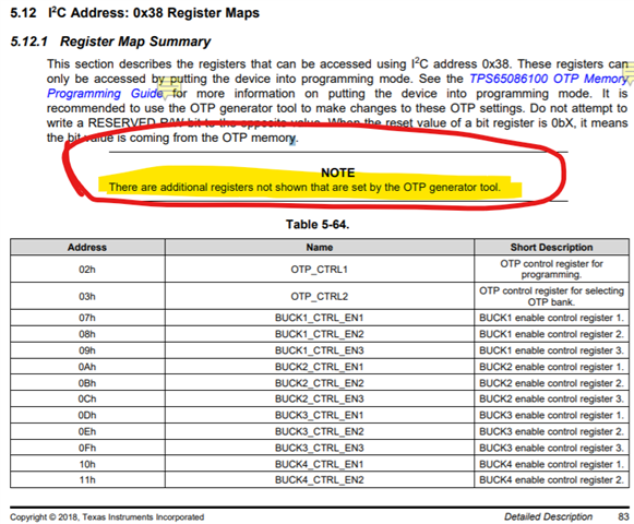

With reference to this note in the document linked below:
https://www.ti.com/lit/ug/swcu188/swcu188.pdf
I can't find a register with these settings anywhere in the datasheet or user guides.   Would someone please direct me to the correct location?
Don

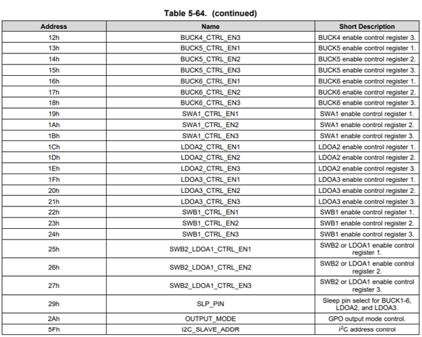

  • Thanks Daniel,
    Are you referring to this datasheet:
    https://www.ti.com/lit/ds/symlink/tps650861.pdf
    Specifically pages 83 and 84:
    There are additional registers not described in the datasheet.   I suspect that 0x53h is one of those.    If I'm mistaken, please do correct me on this point by identifying the section/page number of the datasheet where I can find this information.
    I've also looked in the OTP generator script tool and found that the script writes 0xA8h to register 0x53h at I2C address 0x38h.   Though no information is given in the tool and what this register actually does, nor is there any reference that I could find regarding VTT ILIM.
    If a write is all that's required, then the information contained in the TPS65086100 programming manual (section 4.5 script generator sheet) on page 11 requiring the read-modify-write is incorrect.
    Summarizing, please indicate whether a simple write is required (and confirm that the TPS65086100 Non-Volatile Memory Programming Guide will be amended), or whether a read-modify-write is required (and confirm the correct bits of the register by way of register bit definition).
    Don
  • Hi Don,
    Not all the registers are shared in the datasheet. But that is the only document shared with a register map.
    As for the interpretation of the programming guide and the OTP generator, the programming guide is simply stating that specific values are necessary for the VTT ILIM register and so if this register is being changed manually on its own the best way to ensure these values are correct is a read-modify-write. However, the OTP generator sets these values correctly automatically before writing and thus does not need to follow the read-modify-write process.
    In conclusion, the OTP generator can be used as is and does not need to be modified to include a read.
