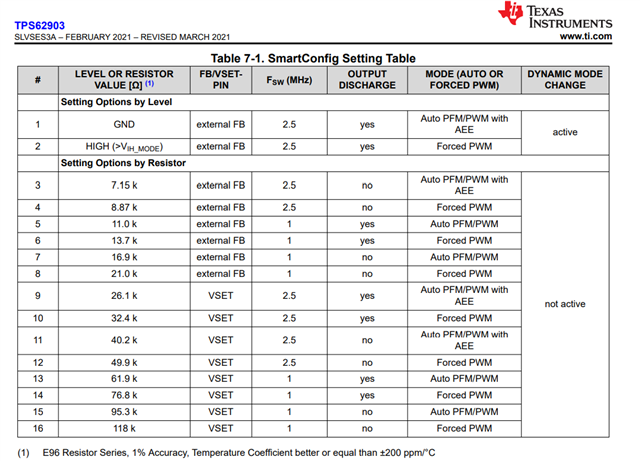

  • Hello Tahar,
    Thank you for the fast response.
    For the MODE/SCONF pin setting, I don't know how to process it. Please see the picture below. Could you please give the reply to following questions? Thank you.
    - In our 3A lighting product, when the voltage of FB pin sets to <=0.1V, should I select external FB mode or VSET mode?
    - If OUTPUT DISCHARGE is YES, will SW pin output the voltage?If OUTPUT DISCHARGE is NO, will SW pin keeps to output 0V?
    - At Forced PWM mode, is the duty cycle of PWM fixed? If not, how can I change the duty cycle?
    Steven
  • Hello Steven,
    1- you can the external FB
    2- The purpose of the discharge function is to ensure a defined down-ramp of the output voltage when the device is being disabled but also to keep the output voltage close to 0 V when the device is off. There is an internal bleeding resistor connected to VOS that get enabled when the device is off to ensure the VOUT ramps downs to 0V. The discharge function is enabled as soon as the device is disabled, in thermal shutdown, or in undervoltage lockout. once the device is disable the device will stop switching regardless of  discharge function.
    3- In FPWM, the switching frequency is well maintained however the Pulse width that changes as the load changes. for a fixed IOUT, the duty cycle changes with with VIN/VO ratio.
    Thanks!
    Tahar
  • Hi Steven,
    for question 3, you can use equation 3 in the datasheet to estimate the TON time  in FPWM and  continuous conduction mode (CCM)
