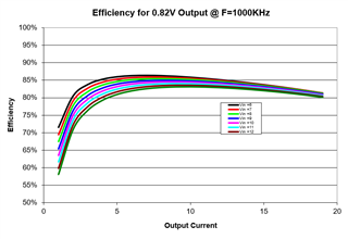

    I want to use BUCK2 for 0.82V@19A peak current. The input voltage is 6V-13.2V (Nominal 12V).
    I will use the CSD87588N external FET that supports this high current.
    • What is the efficiency for this case?
    • What is the recommended inductor for this case?

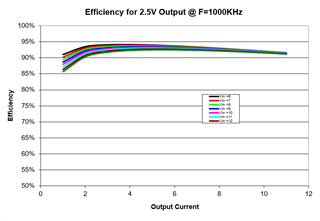

    I want to use BUCK1 for 2.5V@11A peak current. The input voltage is 6V-13.2V (Nominal 12V).
    I will use the CSD87381P external FET that supports this high current.

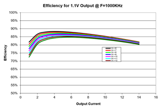

    I want to use BUCK1 for 1.1V@14A peak current. The input voltage is 6V-13.2V (Nominal 12V).

  • Hi Moshe,
    For inductor selection, please see datasheet section 6.2.1.2.1.1 on selecting the inductor.
    https://www.ti.com/lit/gpn/tps650861
    For the efficiency estimates, please keep in mind that these are only limited estimates.
    CSD87588N for 0.82V@19A
    CSD87381P for 2.5V@11A
    CSD87381P  for 1.1V@14A
    Daniel W
