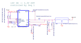

Hi Team!
I designed the circuit as shown in the figure below, but IC destruction occurs frequently. 8pcs./20pcs.
There is no output from the SW and it is generating heat.
Maybe the output FET is broken in short mode.
What could be the cause?
postscript. The specification says that the VIN is 3.5V ~.
What happens to the VCC output at that time?
I don't think the LDO output 5V can be output.

    do you know when the device be damaged? what is the C1058 and C1059 value? and can you share the layout?
    Tks
  • Hi
    C1058 -> 4.7uF  C1059 -> 220nF

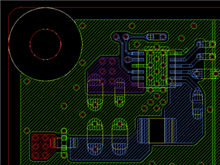

    The foot print is below
  • HI
    do you only have C1058 and  C1059 at input side, is there no any other capacitor between input and input voltage. and if you power up the device, can you measure the input pin voltage and SW voltage ?
