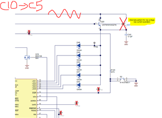

    Can i say that the maximum sink current of LEDx is 3mA? I need to use 3 LEDs. Need to calculate the power dissipation of BJT (see if can use smaller BJT).
    Also, can i connect the BJT collector to other cell voltage e.g. C5 instead of C10? to have lower voltage to reduce the power dissipation of BJT? Please refer to figure below.
    On the EVM schematic, what is the low voltage and low current operation that allow us to use the smaller BJT?
    Do we need to place a resistor at BJT collector?

    The BQ78350-R1A data sheet does not give a tolerance on the 3 mA sink.  You might provide a good margin for variation, perhaps 4 mA maximum per output.
    Connecting the current path for the collector provides the LED current from the top of the pack so that it does not imbalance the pack.  This might be more of a consideration if the LEDs are on for some time.
    The voltage would generally be how many cells are used and the current how many LEDs.  For 6 cells the voltage would be 60% of a 10 cell design.  With only 3 LEDs the nominal current when all are on would be 9 mA vs. 15 mA if all LEDs were used.  The power for a 6 cell 3 LED system should be only about 36% of a 10 cell 5 LED design.
    The resistor in the collector dissipates some power at the resistor which would otherwise be in the transistor.  It would not be necessary but will allow spreading the heat on the board and may allow a lower power transistor.    Of course if you have a 3.3V or similar from a switching supply for other circuitry in the battery you could use that for the LED power and avoid the transistor and its dissipation.
