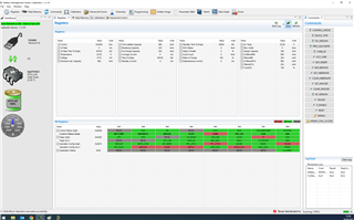

    Thank you for your reply. Now I performed learning cycle with BQ27510-G3 EVM board and after relaxing the battery for 2 hours (after charging) my Update status 1 has changed to 01 but Update status 0 remained 00. What is the difference between Update status 0 and Update status 1?  Is it correct if any of the update status change or both should change?
    Please refer the attached image.
