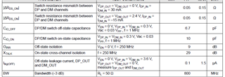

Hi, Yuping,
Please check the datasheet EC table - HIGH-BANDWIDTH ANALOG SWITCH. I think you can use those parameter to build a model for simulation.
