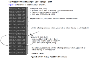

    This is true for SPI as well, but with the SPI there is some repeated reads from a register to make sure the data is ready. I'll take an example from the BQ769x2 Software Development Guide (https://www.ti.com/lit/an/sluaa11b/sluaa11b.pdf ).
    In the example below the Cell1 voltage is being read which is two bytes located at 0x14 and 0x15. For SPI, we recommend reading until the data is reflected back on MISO. In the section where is says "MISO is reflecting command written", this shows the first byte of the reading. However, when we start to read from 0x15 in the next step, it reads 0x14 (previous command again). This is the safer data to record because it is latching the 0x15 data too. So for 2 byte readings, they should grad the data in the circled section since it can safely be paired with the data coming on the 2nd byte.
