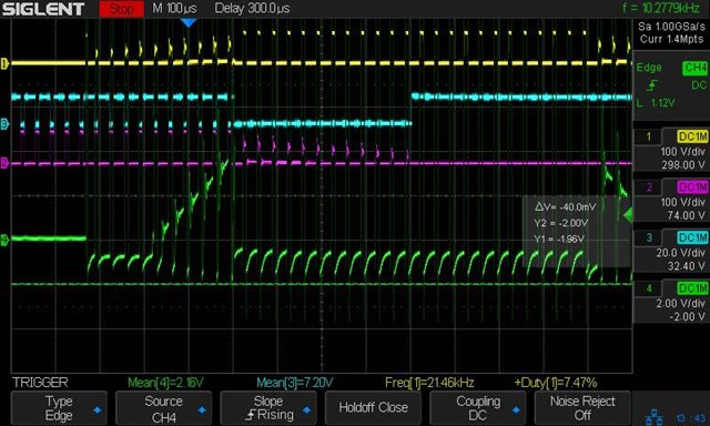

    I've just captured a scope trace showing the voltage at the VS pin, as measured directly at the pin using a RF SMA connector. It looks like we have large negative voltages on the VS pin. I would expect to see some negative spikes here for a very small duration as the freewheeling current is absorbed by the diode in the lower FET. However as can bee seen below, a large portion of the phase is below zero.
    Below: Green - VS Pin measured at device, other colors are gate signals.
    As the DC link voltage and motor RPM increase, these values get quite large, and I could easily see the -HS transient value being exceeded, as well as the HS-HB voltage maximum of 20V if the negative spikes integrate across the capacitor.
    There is mention in the datasheet (8.2.2.7) about extra transient protection. I think our next point of call will be to add a 2R resistor in series with the HS pin, and maybe an additional schottky diode between GND and HS, but I'd have to find one with a large enough voltage rating.

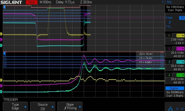

    4th update for today.
    So we setup an experiment, diving only a single pair of FETs with HS connected to one motor terminal, and the other grounded.
    We start off with a small amount of PWM, and increase it somewhat. At 60V we have nice clean waveforms, everything is good.
    At 75 VDC, at the very first PWM pulse we get an explosion, with the lower FET cracked, and the gate driver failed.
    The moment of destruction is shown below:
    1. Yellow - LO
    2. Pink - HI
    3. Blue - HS, Green = Motor Terminal
    I think its probable that the lower FET has switched on. I did not have the scope down low enough, but the upper FET was absolutely on at this point.
    So things brings to the question, is the failures we have been seeing the gate driver not holding the LO pin low enough for our VGS_thresh of min 2.0V.?

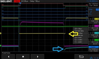

    Last night we built a new batch of inverters and fitted 1.5K pulldown resistors between gate and source of all our FETs. Magically our LO side gate waveforms now stay below the Vg_th value of our FETS and the gate ringing, which we are pretty sure was caused by the LO FET's switching on for an instant is also gone.  So I think this is one issue fixed.
    Today we did a moderate power run, 60 VDC bus voltage. I've attached a screenshot below showing the performance with Gate-Source resistors fitted, along with the two Schottky diodes, and no current sense shunt as per previous posts.
    Again, these waveforms are taken as close as possible to the devices, using RF-SMA connectors.

    I note that we have a small negative pulse on the LO side (yellow) with the pull down gate-source resistors fitted. This could be of no issue as we are switching quite a bit of current at this point. And we have a small blip in the VDC Bus (Green) trace which could just result from the change in voltage due to the power supply inductance during the dead-band period. We will have to do a detailed study of this pulse later on.
    However the HS (Blue) is our major concern here. What is shown in the above plot is one third of a 3 phase inverter with the high side FETs activated.
    At the point on the scope capture at the blue arrow we see:
    1. The HS pin go to about -4.0V. And we note that this pin goes more negative with additional current consumption and a higher VDC bus voltage.
    2. The pulse width of the lowest voltage 'blip' on the HS pin is greater than the 100ns value in the datasheet for -14V.
    3. It would be likely to violate the -10V Vhs limit when we apply a much higher Bus Voltage / phase current.
    4. The HS pin is absolutely negative at this point, and the LO gate driver is on, hence the HS should be at VSS as you can see HO is at VSS at the point of the yellow arrow.
    I'm wondering if you could shed some light as to what I am seeing in the blue trace at the arrow on the screen capture.? I get the feeling that the "blip" at the blue arrow, could either be the natural FET switching cross-over, or Cboot recharging?
    I am also wondering what structures are inside the driver that I could further protect externally?
    For example if I (re)placed a small 2.2R resistor in series between the driver's HS pin and the FET's would this resistor limit enough current flow into the gate driver to prevent damage, or would I need to add, for example, and external diode between VSS and HS with the 2.2R resistor in place to absolutely protect the driver?
    Thanks again for your time!
  • Hi Stomp,
    Thank you for sharing your latest findings. I'm glad you were able to solve the ringing issue at the low side gate.
    Regarding the negative transient on HS pin, switch node undershoot can occur when the load continues to draw current as the high-side FET turns off, forcing current through the freewheeling diode of the low-side FET, which induces a negative voltage. This can be caused by parasitics inductances on the traces and can potentially cause the bootstrap cap to be overcharged.
    Slides 7 to 9 in this technical document talk in detail about switch node negative spike and recommendations to reduce it: https://www.ti.com/lit/pdf/slyp766?keyMatch=JACKIE%20HUI
    This FAQ explains this in details and has recommendations to avoid bootstrap overcharge: https://e2e.ti.com/support/power-management-group/power-management/f/power-management-forum/931493/faq-ucc21520-what-do-i-need-to-know-about-bootstrap-overcharge-when-designing-a-driver-bootstrap-supply?tisearch=e2e-sitesearch&keymatch=overcharged%20bootstrap#
    Other than the transient, the duration of the negative voltage on HS is a concern. Could you explain what is going on on the converter during this time?
    Please make sure that when HS pin is negative, the conditions mentioned in datasheet section 7.3.6 "Negative Voltage Transients" are followed. It would be good if you monitor HB voltage as well to check these conditions.
    Leslie
  • Thanks Leslie,
    Thanks document slyp766.pdf was very informative.
    The blue arrow on our previous scope capture is the reverse recovery charge from our FET's, as described in a few papers we have found. There is nothing we can do about this, other than to say our PWM method for commutation is to switch on the low side FET inverse to the high side FET in a "balanced mode", such that we use the Rds_on of the FET, rather than rely on the body diode (which dissipates more heat). This is opposed to using only "upper modulation" as seen in several BLDC trapezoidal motor drive control papers.
    I conducted another test last night, and achieved a full power / full duration run on our motor dive.  I monitored HS very closely, and at full power I only got to -6V, which is still within the limit.
    So I'll mark this as solved, thanks again for your help.
