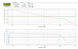

1. 1uF capa, slew rate limiter and 10uF on output
We used a 4Ohms load.
Here is the worst case with 2V input voltage :
Phase margin is 80° and gain margin 11dB.
The system is stable.

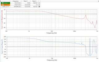

2. only 1uF capa on output
We used a lighter load of 20 Ohms.
Phase margin is ok : 85° but gain margin is a bit low : around 5dB.
The low gain margin is due to the pic around 300kHz.
Is it something we should worry about or can we safely keep the 1uF capacitor at startup ?

  • Hi Guillaume,
    Good to see you again and thanks for your questions. I see not much difference between your method and mine. For the test results with only 1uF capa on output, the gain margin is low. This could be caused by two reasons:
    1.1uF capacitor capacitance is too low at that DC bias. Or 1uF is not sufficient to keep gain margin enough. You need to add or increase the capacitance;
    2.Input filter. Refer to below application note. Without well design, input filter has something to do with gain margin at high frequency. You need to add a big capacitor at input side to check if the loop is influenced by input network.
    https://www.ti.com/lit/pdf/snva801
    -Wenhao

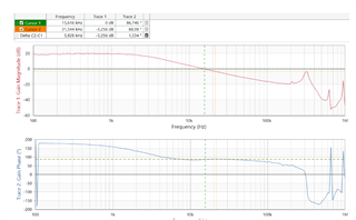

  • Hello Wenhao,
    Following your advice we made a few more measurements.
    However none of the 2 options seems to resolve the issue because the peak at 300kHz is always there.
    1. Measurement with 4.7uF output capacitor and 2.5V input voltage :
    2. Measurement with 10uF added at the input and 2V input voltage :
    There seems to be some kind of resonance in the circuit, perhaps between the inductance and the output capacitance.

  • Hi Guillaume,
    Sorry for delay. I think you should keep the device in PWM so its bode plot is of most meaningful. TPS61021A would enter power save mode in light load. Let me check with design of threshold entering PSM.
    TPS61021A implements valley current COT control and there should be no resonance in gain plot, as inductor has been "cancelled" by valley current sensing.
    -Wenhao

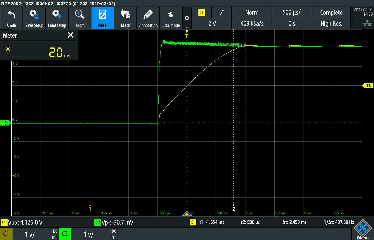

    However the reason we are doing these stability analysis is to make sure the TPS61021A will remain stable during startup with a slew-rate controller (ref here https://e2e.ti.com/support/power-management-group/power-management/f/power-management-forum/1024194/tps61021a-slew-rate-limiter/3806487).
    Startup duration is around 1ms and load is always light at that point (we wait a little before enabling the load). So during startup the TPS61021A  mainly charges the 10uF capacitor.
    I think the TPS61021A operates in PFM during this phase.
    Measurements during startup ( yellow is slew rate output, green is TPS61021A output) :
    That's why we made the analysis with light loads for the 1uF only case.
    Guillaume
  • Hi Guillaume,
    Understand. I just checked with design. The device enters PSM when inductor valley current triggers 200mA. This means, if inductor Ip-p is 1.1A, the device stays in power save mode whenever inductor avg current is below 200+1100/2=750mA. For 2Vin to 4.2Vout, it means 320mA load current (90% efficiency).
    Stability:
    The stability in power save mode is always stable, so there is no need to check stability;
    The stability in PWM needs to be checked with only 1uF caps, which needs load to be higher than 320mA;
    Soft-start charge current:
    The typical soft-start time is <100us for your 1uF capacitor, so charge current is around 20mA. Plus your load of 40ohm, the maximum current would not exceed 320mA.
    This means the device always stays in power save mode during start-up. If there is no possibility of more load current, the device is always stability. However, as you could see during slew rate controller is activating, TPS61021A are seeing more load. Before 10uF is fully on Vout, what current TPS61021A is seeing is 10uF charge current+load current. You may check if it is exceeding 320mA. Thanks!
    -Wenhao
