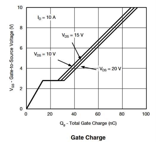

    I mentioned "?" in the "Total gate charge" because the quick start calculator is saying "VCC current limit" when I fill 135nC in the MOSFET total gate charge blank. But the MOSFET I used, is the one the WEBENCH suggested me... Do you think is it really going to be a problem? If so, could you, please, suggest a suitable MOSFET for these three cases (+15V, +6V and +2V)? I mean, a MOSFET that would be suitable for the three applications?

    The Qg of the FET should be taken at the nominal VCC voltage of the LM25085. 135nC seems very high. The IC's current consumption just related to driving the FET is Ivcc = Qg*Fsw, and this should be less than the VCC current limit. Send on the FET part number if you need more support.

    If I consider 135nC, the VCC current limit is overloaded. The FET used is the SI7149ADP, as mentioned in the LM25085A_Quick_Start - 15V.xls file. Could you, please, confirm to me which Qg should I use? If we have to consider 135nC indeed, could you, please, suggest a compatible FET for this application?

    From the datasheet, the Qg of that FET at VCC = 7.7V is ~70nC
    Consider the SiR167DP (5mOhm, 55nC @ 7.7V) or Si7143DP (10mOhm, 35nC @ 7.7V) instead.
