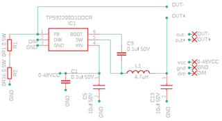

Hello everyone!
I set up the diagram as attached, but there is no voltage/current at the output... could you tell me what I did wrong?

please note that the recommended input range is 4-30V.

hi,
i find there is no diode in the schematic. please refer the schematic in the datasheet carefully.

yes, the power supply was made with 12V… I connected a series 3 leds of 3V 0.7A to the output and entered with 2.5V PWM on pin 2… I cannot measure the PWM frequency, but it is being generated by a basic circuit with 555…
