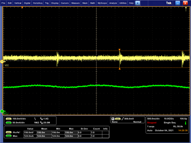

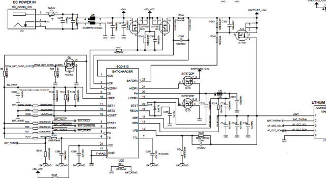

 I have a design that is almost identical to your EVM. It is a 2 cell (8.4V) circuit with fast charge current set to 0.5C of a 2.6A battery pack (1.3A).
The pre-charge current is set to 0.1C or 130 mA. When I start charging a battery it only pre-charges for a 1/2 hour then shuts off, despite voltage
VLOWV being greater than 1.75 volts. If I momentarily ground the CE pin it charges again at 130 mA for another 1/2 hour. What could cause the
charger not to fast charge? Does the charger only fast charge when the battery is completely depleted? <6V
My only difference from the EVM design is I am using a 10uH inductor as this is our standard part.
