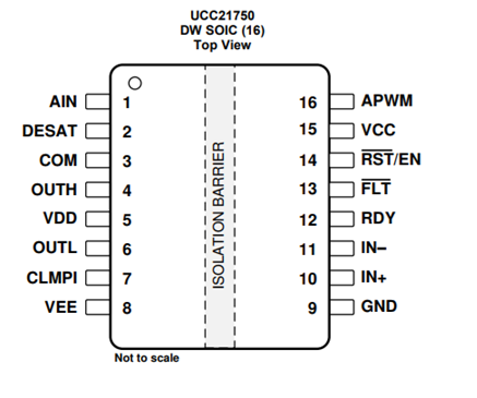

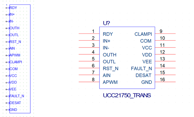

The customer have imported UCC21750 unencrypted PSPICE Transient Model(SLUM718) to PSIM tool and cadence PSPICE tool and can get like below image.
but the port number and name is different from datasheet. is it right? The encrypted model is same to datasheet.
If the below image from UCC21750 unencrypted .lib file is right, Is there any reason why you made it different? and Is there any problem with simulation?
<Datasheet>
Thank you.
  • Hi Dino,
    The pins are not located in the same position as the actual device, but will still have the functionality of the pin name(e.g. OUTH is still OUTH, OUTL is still OUTL: they're just in different positions).
    When someone downloads the encrypted version of the model and runs it on PSPICE it comes with a .olb file which is the symbol associated with the .lib file. This .olb file is already configured to put the pins in the correct positions.
    When importing the un-encrypted .lib file to another modelling tool the modeling tool there is no associated .olb file so the software will likely automatically create a symbol. This symbol should be able to be edited through the software to at least separate primary and secondary pins.
    I would recommend the customer looks into resources for the modelling tool they're using too see how the symbol can be edited.
