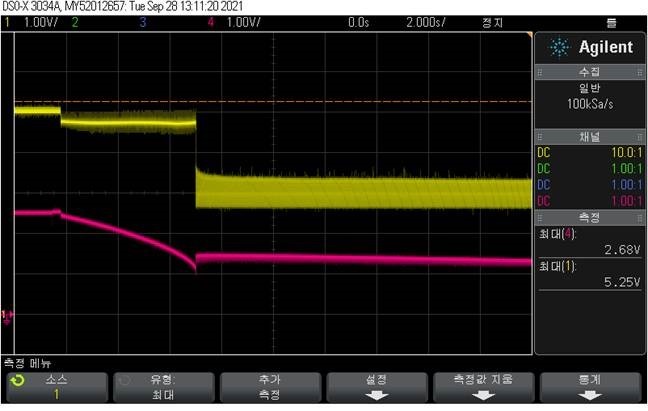

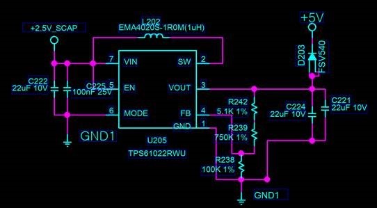

The SW pin was shorted to GND while testing the Supercapacitor backup power supply with the TPS61022 at the customer.
I have attached the circuit diagram and waveform, so please check it.
Yello : VOUT
Red : Vin

Hi Louis,
For TPS61022 working in Supercap backup power supply application, please follow the app note to re-design the schematic. The reason is at low Vin condition, the device needs to be carefully compensated, otherwise the loop is unstable.
Could you also share the layout, the failure issue is highly possible related to layout. Thanks.
