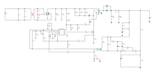

Hii Everyone,
I have designed a 19 V, 60 W ac-dc converter using UCC2803 on tina ti took help from Webench, but it is giving convergence error. Attaching the simulation file and Webench circuit screenshot. Please suggest.
Thank you!!

Could you upload the updated simulation? I run your original simulation mode. The output voltage VF1 is normal.
Hii Jerry:
I haven't updated anything but still not getting proper output voltage.
Analysis-Set Analysis parameters. You can change the parameters and try again.
Your system is very complicated, I don’t know the specific parameters. You can try to change the TR max.iteration number, TR maximum value relative error.
Hii
Can you tell me what is use of both the bipolar transistor used in the circuit??
