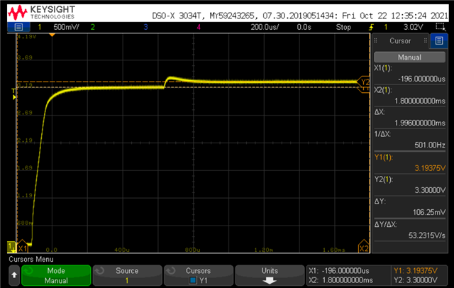

Device switch to fail state (Critical Error 93), if the temperature of product is near to -30°C.
Working temperature of device is -30°C/+50°C

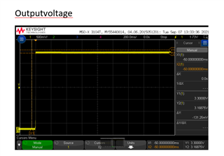

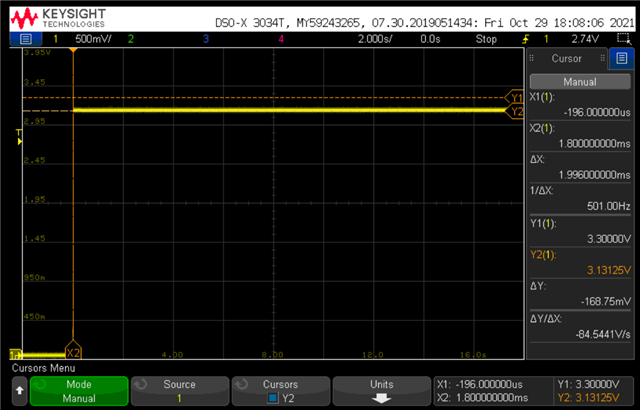

The LDO N1 doesn’t generate a correct reference voltage p3V3_REF.
Failure – at the temperature near to -30°C the output voltage of N1 is about 3.15V instead of 3.3V. The voltage tolerances are 3.3V+/-1%. The output voltage is out of tolerance.
It causes that the ADC Selftest in MCU fails.
3 Conclusion
the defect part 1174210 (TPS70933) on position N1 was detected.
Part details:
Internal part number: 1174210
Manufacturer: Texas Instruments
Manufacture part number: TPS70933
3x on PWRBoard (N1, N2, N13)
Please, whot will be nex step?
