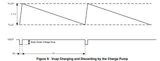

Does the part# LM74670-Q1 (or any similar zero Iq smart diode) contain any inductors/transformers, or is it switched capacitor based? I don't want any inductors/transformers (not including parasitics).
Also, for my clarity, the device can step up 0.5 volts to around 6 volts correct?

    LM74670-Q1 device does not step up 0.5V to 6V. This device is not at all related to step up / step down converters.
    This device can drive an N-FET which can replace a schottky diode in applications where the diode is used of input reverse polarity protection/blocking. One such application is replacing schottky diodes in full or half bridge rectifiers.

    I should not have used the phrase "step up", and I'm clear that it drives an N-fet. The question rephrased is: if 0.5V appears from anode to cathode, will a multiplied voltage of around 6V appear (after charging period elapses) between gate drive pin to anode?
    Also, I'd still like to know whether it contains any inductors/transformers, or is it switched capacitor based instead?

    Yes, the internal charge pump which is based on switched capacitor topology can generate a voltage of up to 6.3V as long as there is a minimum voltage of 0.48V across Anode to Cathode. As shown below, the Gate is turned off for a small duration of time to use the body diode voltage of the FET to generate the charge pump voltage.
    There are no inductors/transformers integrated in the device. As mentioned above the charge pump is based on switched capacitor topology.
