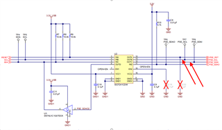

    1. EVM schematic:
    This is re-confirmation. EVM schematic doesn't have pull-up as arrow shows. Does the pull-ups not need at the line? I guess SCL and SDA line which primary side of ISO7241 has pull-ups. It already send "high" or "low". Then Pull-ups at PSE-SCL and PSE-SDAI doesn't require pull-ups. Is it correct?

  • Hi Nagata-san,
    1. Looking at the datasheet of the isolator, it has a push pull outptu stage. So the internal FETs will allow the pull up and pull down of the output signal. So there is no need for pull resistors since it is not open drain output.
