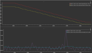

Since few weeks ago, by increasing max discharge current from 23A to 30A (only during a 10s spike), we have been observing some weird cases that we would understand, an example follows.
With a 75 cycles battery (more in reality, but our charger leads to not detected end of charge), SOH 96%, voltage 16.19V on a 4S LiHV pack, we observed that while consuming small current (450mA), SOC drops down by itself from 73% to 44%, same behaviour on integrated and remaining charges, which seems not in agreement to the current and average current.
Do you have any idea from where it comes from ? is it the gouge by itself ?

    So the average current and average power are not aligning? What is the lower section of your graph? Was the only change done was increasing a 10s pulse from 23A to 30A?

    Yes, average and actual current are not aligned with the remaing charge curve, the remaining charge has a much higher rate that the one corresponding to the currents... leading to a huge drop in SOC values, but not the reality...
    The only change we do is that during ~30s, we ask around 30A at device start, before it was close to 23A.

  • Here is the log generated during 2 small currents after the high current period. We can see the bad remaining capacity decrease rate, as the SOC incredible decrease. I hope it is that you need.
    Best regardsIssue.log

    During this test, we should not having lost so many SOC%, only few % were expected (validated by an external power load also)... The RemCap is decreasing too much faster, compared to the real current we were using, it is completely abnormal (easy to compute using the integrate of current or averageCurrent compared to the RemCap curve...). For us, current and averageCurrent values are fine, RemCap and SOC completely wrong for a 3700mAh battery.

    It looks like the gauge is expecting a much larger decrease in RemCap and SOC from the load that is on the batteries.
    If you compare the RemCap to DOD0 passed Q (the raw coulomb counting from the gauge) you can see the gauge knows how much has passed, but is expecting a lot of other reductions from it's simulations based on temperature and the Ra table.
    You can try changing load select to 0 instead of 7 so the gauge simulations aren't at such a high current. I noticed in your .gg file the Avg I Last Run is 1846mA and the Max Avg I Last Run is almost 20A, that's why the gauge is thinking there is much less capacity.
