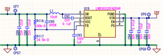

My customer is evaluating LMR36520 and encountering poor efficiency at a light load.
I would be grateful if you could advise.
When we prototyped the circuit of LMR36520 and measured the power conversion efficiency, the result was about 10% worse than the data sheet.
In the data sheet, 24V input, 0.1A load, 5V output, at least 80% or more.
Even when compared with the result of simulation with Webench, it is about 10% worse.
Request(1) Could you please let us know what is the cause of the inefficiency?
Request (2) Could you please confirm the efficiency of the datasheet.
The efficiency in our circuit
Input power: Vin 27.5V x Iin 46.8mA = 1.287W
Output power: Vout 5V x Iout 172mA = 0.86W
Efficiency: 0.86 ÷ 1.287 = 66.9%
Input power: Vin 19.6V x Iin 61.8mA = 1.211W
Output power: Vout 5V x Iout 171mA = 0.855W
Efficiency: 0.855 ÷ 1.211 = 70.6%
The input and output voltage is measured nearby the device.
Schematic
BOM
LMR36520 BOM.xlsx
The result of Webench
LMR36520FADDAR using Custom Part.pdf
I appreciate your great help in advance.

  • Hi Shinichi,
    Your customer has choosen LMR36520FADDAR, which is the FPWM version. FPWM mode is fixed pulse frequency switching, which will bring higher loss at light load.
    The efficiency graph shows the LMR36520ADDAR, which is PFM version. This mode will change switching frequency under light load, thus reduce loss.
    I also simulate this circuit on Webench, the result shows similar with what your customer has tested:
    WBDesign8 (1).pdf
    Feel free to reply if you have further concern.
    Sirui

  • Hi Shinichi,
    We are sure about the accuracy of the datasheet data since it's validated before release, but currently we don't have validation data of LMR36520FA, we suspect there are two possible causes: the test method, or webench result too high in light-load.
    There is one thing you can recommend your customer to do: test the circuit under mid-load or heavy-load, thus the device could work on PWM mode. Under this condition, if the test result is close to datasheet efficiency, then we can say the test method is correct.
    If your customer cares light-load high-efficiency very much, we recommend to use LMR36520 w/o FA version.
    Sirui
