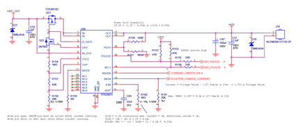

  • Currently, I have placed a 1uf capacitor to the dvdt pin. I have tried with no capacitor, 100nF, 220nF and 1uF. On every single one the device went into the Thermal shutdown after 2.5s. I am reading the IMON pin to see the current going through the device.
    IC Setup: https://prnt.sc/1w2xvp0
    Basic Block Diagram: https://prnt.sc/1w2yzlk
    Before experimenting with the dvdt mode my setup was a little different. When the IC first started working it was connected to a dummy load of 1K8 Ohms. Then after 3s I switched a relay to connect to the main battery. However in this scenario the dvdt was not used. When I made the relay always open, the dummy load is eliminated from the circuit and the battery is connected directly. However at the startup IC heats up and wents in to Thermal shutdown. Is there something I need to change on the schematic or is this current limiter not compatible for battery charging control.
    The Setup where I could get the IC working without Thermal shutdown: https://prnt.sc/1w2zmi6

  • IC Setup:
    The setup where I could get the IC working without Thermal Shutdown:
    Here you go, sorry for the inconvenience.
  • Thanks
    Battery charging needs extended period of current limit mode of operation. This device only supports 2.5s interval. We don't have solution for your requirements.
    You may need to use cv/cc based charger.
