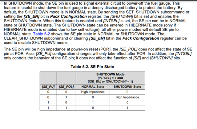

How to enter shutdown mode? SE is push pullup and SE-PU SE-POL set to 1.

Please see the attached image from the Shutdown Mode section of the BQ27542-G1 TRM.
In your case with SE-PU and SE-POL set to 1, the SE pin will be 0 for NORMAL mode and 1 for SHUTDOWN mode.
Additionally to enable this feature, you should set the [SE_EN] bit in the Pack Configuration register. [INTSEL] should also be set.
