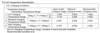

My customer is looking for a charger IC for CELL with the following charging conditions.
Is the BQ24133 suitable as a charger IC for this?
If there is a more suitable charger IC, please recommend it.
Thank you.
