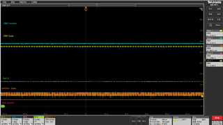

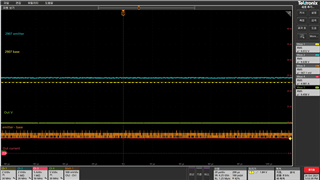

  • Hi Timothy
    The CC operation of the designed board seems to be done.
    Referring to P.2 in the document snva829, the cc current was calculated as 14.27A and designed.
    However, the voltage drops from more than 3A.
    In relation to this, the waveform are as follows.
    What is the reason for not operating CC according to the calculated current (14.27A)?
    Additionally, please review the circuit I requested before.
    -Waveform-
    Ch1(Yellow):TR(Q7) Base Voltage
    Ch2(Blue):TR(Q7) Emitter Voltage
    Ch3(Red):Output Current
    Ch4(Green):Output Voltage
    Math1(Orange):TR(Q7) Base-Emitter Voltage
       <Output Current 3A>
     <Output Current 5A)
     <Output Current 10A)
  • Hi David,
    Recommendation is to verify the circuit first in CV mode and then add the CC circuit. If the CC circuit is pulling on FB at 3A, you can check the circuit nodes to analyze the circuit behavior.
    Here is the applicable expression (from Equation 1 in app note SNVA829):
    where RFB is the parallel combination of the upper and lower FB resistors.
    Tim

  • Hi David,
    Is the circuit working correctly at a certain CC current level? If so, just adjust the setpoint as needed.
    Here are some steps:
    1. Disconnect the CC circuit (e.g. lift the NPN transistor) and verify the circuit runs in CV mode up to ~20A (the current limit setpoint must be set above the CC setpoint).
    2. Remove the connection to the FB pin of the IC from the CC circuit and place the same Thevenin feedback resistance to GND. Then check that the CC circuit is engaging at the correct output current.
    3. Finally, connect the CC circuit to the CV circuit and verify they are both operating correctly as expected. Note that it is important to keep the FB trace as short as possible to minimize noise. The lower FB resistor should be located at the FB and AGND pins.
    Tim
