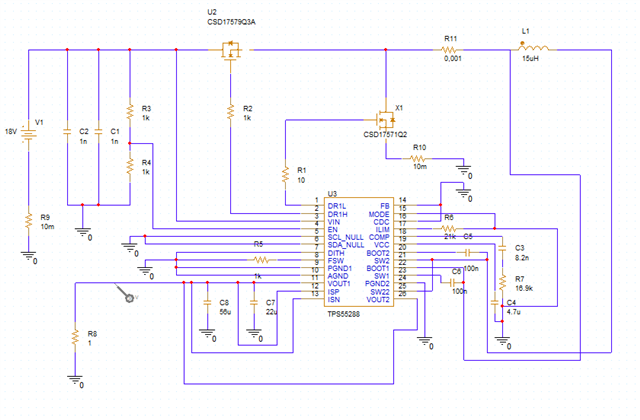

Dear Team, I am trying to simulate my circuit on Pspice then I am getting this error i.e. ERROR(ORPSIM-16144): Value may not be 0.
Can anyone help me out in this ?

Hi Akhil,
Thank you for reaching out on E2E.
Is there any details about which value may not be 0?
BTW, it seems the TPS55288 circuit external components, such as inductor value, driver resistance, external compensation parameters, etc. are not selected in the datasheet recommended range. These could also lead to simulation error. Please use TI webench to simulate the circuit or refer to TPS55288EVM schematic. Thanks.
