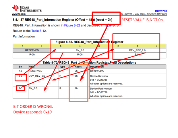

Part Number: BQ25798
Customer noticed an error in the datasheet, can you please confirm. Details below.
Thank you in advance.
