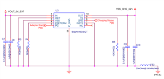

We used BQ24045 Charging IC for the charging of 3.7V 800mAh battery (min 3V - max 4.2V). But when the battery voltage is below 4.06V and put on the charging then the CHG status pin is not changing it's state, But charging is started at the half of the desired current. When the battery is above 4.06V and put on the charging then all the functionality working properly. So is their any condition in BQ24045 that causes this problem?
