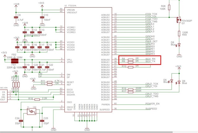

I see the "NOTE: Make sure that the resistor R8 is removed on the TMS570 Launchpad board."
I have a question : I found that the circuit diagram R8 in the design document is 0 ohm. After removing it, the circuit is open, right?
If I remove the R8 in my TMS570 Launchpad , it can work regular when I use BQ76PL455EVM to connect TMS570 ?  or I should short circuit?
Could you tell me why should do that.
Very Thanks.
  • Hello Kuanlei,
    Which document is making this recommendation? I agree that this doesn't make sense based on the schematic you are showing above. I suggest you try to communicate with the BQ device without depopulating this 0 ohm resistor first.

    I found recommendation in http://www.ti.com/lit/pdf/slva617  page 4, 3.1 NOTE.

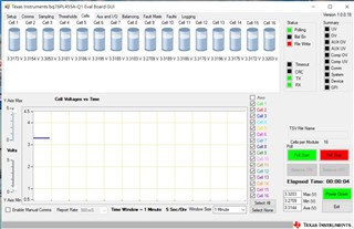

    When I use the USB to TTl cable. The BQ76PL455EVM works as expected right . Figure 1 show that.
                                                  Figure 1
    But,how do I know  it works normally when I use TMS57004 Launchpad with the sample code provided by TI to use it with BQ76PL455EVM.
    Now, I connect the MCU to the PC with USB cable ,and MCU jumper wires to the BQ76PL455EVM.,  then use CCS to run the sample code.Figure 2 show that, also can see the BQ Switch configuration in Figure 2.
                                               Figure 2
    Where could I see the cells voltage when the BQ Send data back to MCU?
    Very Thanks

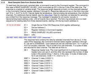

    The read command is  Software Design Reference section 3.3.2 ?
    // Read sampled data from boards (section 3.3.2)
    // 24 bytes - still configured for 8 AFE channels plus 2 AUX channels plus internal digital and analog die
    // temperatures (see code for section 2.2.5.2)
    nDev_ID = 0;
    nSent = WriteReg(nDev_ID, 2, 0x20, 1, FRMWRT_SGL_R); // send read sampled values command
    nSent = WaitRespFrame(bFrame, 27, 0); // 24 bytes data + packet header + CRC, 0ms timeout
    // Send sample request to single board to sample and send results (section 4.2)
    nDev_ID = 0;
    nSent = WriteReg(nDev_ID, 2, 0x01, 1, FRMWRT_SGL_NR); // send sync sample command
  • Hello Kuanlei,
    Yes, that's correct.

    When I used the GUI it can response correct data.

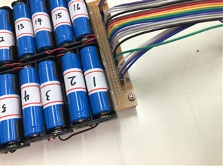

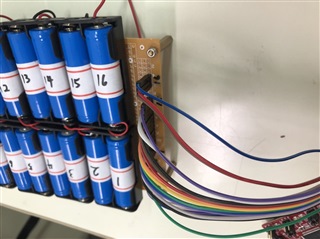

    The hardware part I put the 4 0S wires in the same com & 3 16S wires in the same com & 1~16 wires in sequence.
    Is it connect correct?
  • This is my hardware pictures.
