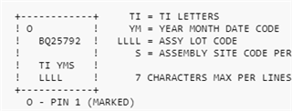

  • Hi Jim,
    The lots are 0AANLZ8 and 0AANLS8.  But again, not all parts show the issue and other lots could be affected.  You could determine the IC's production year and month as explained below:
    Jeff
