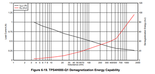

    Thank you for your clarification. I thought that the GND network (resistor//diode) also would help protect the large negative spike during the inductive turn off, based on your previous comment. But, it's not that much helpful, compared to V_ds clamp, correct?
    Do you think that for the relay load (max 150mA) it's enought with the internal V_ds clamp without adding an external component(freewheel diode) to protect the switing off?
    Sam Lee
  • Hi Sam,
    In general, this depends on the magnetization energy in the inductance. At 150mA, the magnetization energy will be quite low.
    TPS1H100-Q1 will have no issues driving this and demagnetizing this load.

    Can you provide the graph of TPS1H000-Q1 which we're actually using?
    Sam Lee
  • Hi Sam,
    We do not have a graph to provide for TPS1H000-Q1 at this time.
    We do have one for TPS4H000 which is the four channel version of the device with 1mOhm on resistance.
    As you can see, 0.15A is a very low current and the supportable inductances are large.
    Shreyas
