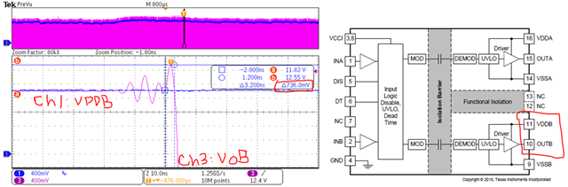

    After discuss with customer ,one thing need you check
    We got the waveform VDDB & VOB High level 0.736V during 3.2ns as below picture!
    As I know UCC21540 High_level over is VDDB+0.5V, like the waveform measured below, does it exceed  UCC21540 specifications? THX
  • Hi Kygo,
    For such a short duration this peak is not likely to damage the driver. That said, it would be better to keep this peak below the datasheet value of VDD +0.5V. This could be accomplished by: 1. Adjusting Rgate to reduce ringing. 2. reducing parasitic inductance in the gate drive path. 3. Adding a ferrite bead near the gate of the power FET.
