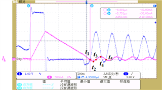

Hi Andrew ,I want to check the oscillation frequency of SW ringing during DCM mode .
Is the fosc=1/(2πL(C1+C2)) ,or just C2 involved in the oscillation which means fosc=1/(2πL(C1+C2))?
If only C2 is involved in the LC oscillation , the circuit loop is the above one . Then the fosc=1/(2πLC2) .
I have tested the oscillation cycle , which needs to be checked if matching the equation .
Thanks a lot !
Hi Nini,
Nice try. From my understanding and previous materials, it is related with C2. But I think you can have a try simply by adding a 470pF cap parallel with C1 (between SW and Vin pin) and see if the oscillation frequency will change.
