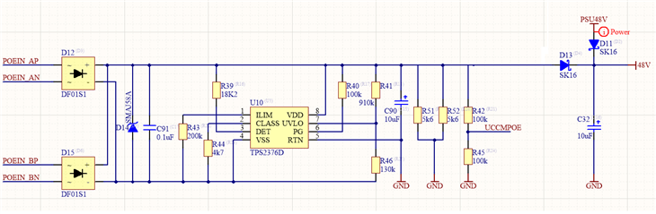

I have 2 identical devices which use TPS2384 for PSE, and TPS2376D as PD chip. Both devices has 5 Ethernet ports.

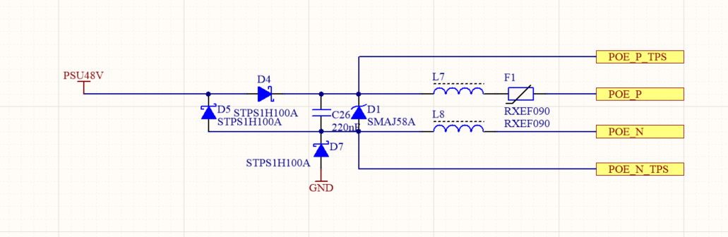

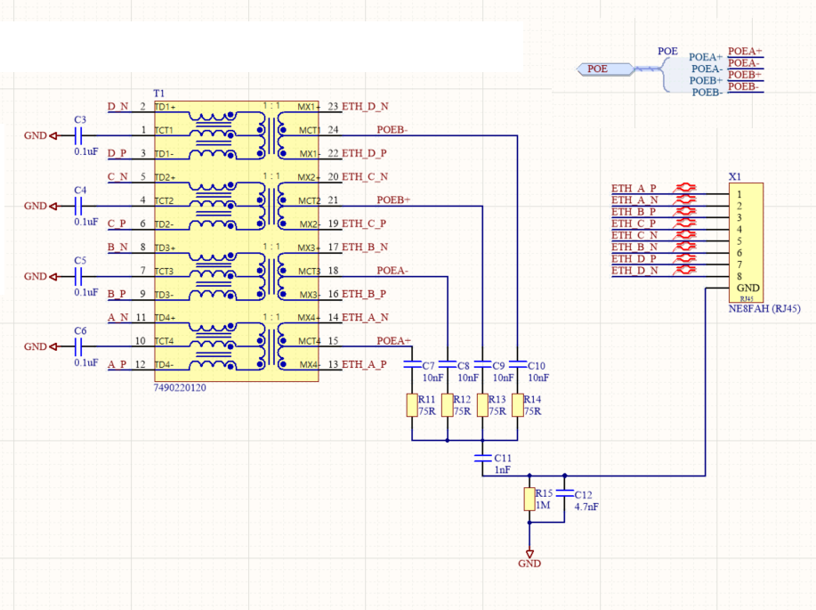

Circuitry regarding POE protection and ethernet transformers are same for both, but I noticed one difference.

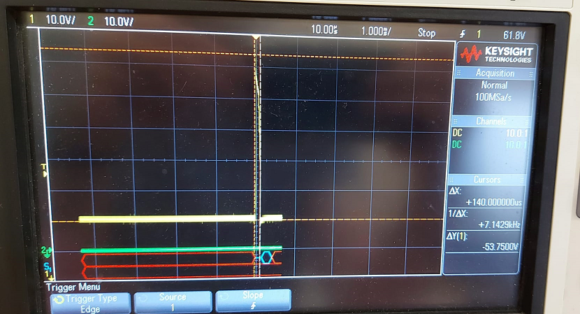

When I connect cable 2-2 on TPS2384 device I get this voltage spike on P net of PoE connection.

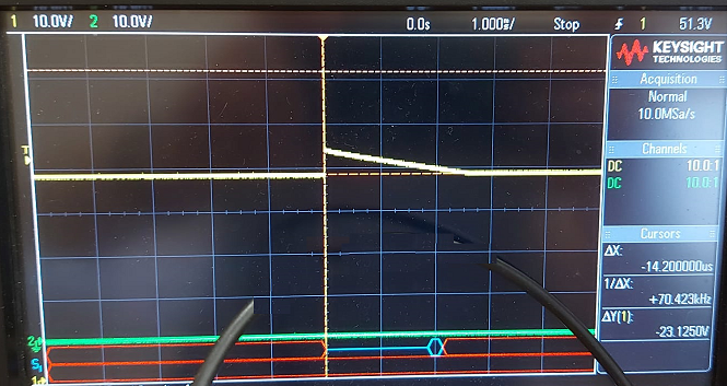

When I connect cable 2-2 on TPS23861 device I get this voltage spike:
I thought maybe this longer duration voltage spike in TPS2384 case would cause Over voltage fault, but then again I dont know why it shows 101 error code.
Below are schematics for my PoE application:
