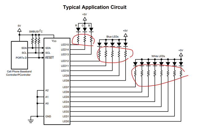

Hi Experts,
I am writing to know how to select these resistance (the red mark on the below picture).
Is there any consideration in the selection of resistance?
Thank you for the help.

Hi Aaron,
This document Pullup_Resistor_Calc introduces the basic equations to calculate the range of pull-up resistors from Page #2~4. In addition, the resistor values also depends on the forward voltage of LEDs chosen in the circuit. It can be roughly estimated by (5V - Vf) / 0~25mA.
