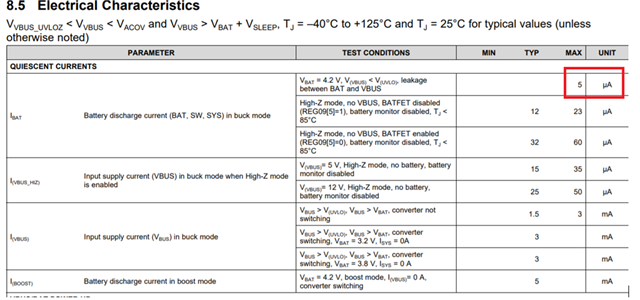

With only battery power, It is found that BQ25890 will consume about 1.76mW (@3.7V),
This power consumption is not compatible with the Datasheet (Figure 1 below).
Q1: When the battery is powered, is there any register that needs to be set to save power?
Q2: I have checked the datasheet (Figure 2 below) which may be related to the battery monitor. Can the battery monitor be turned off to save power when it is powered by the battery?

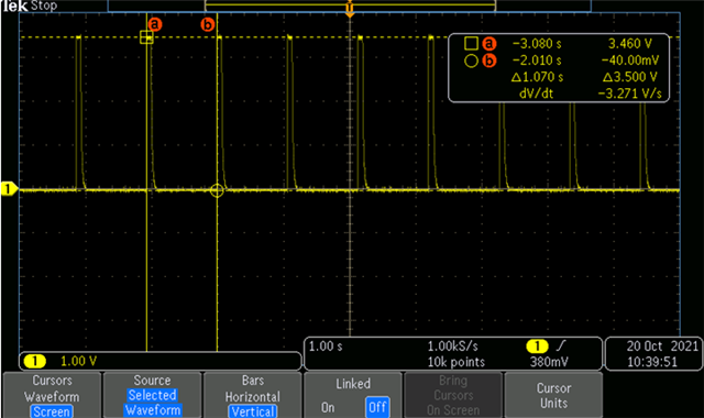

In addition, we found that when the battery is powered,
The voltage of REGN will jump in the following waveform,
Is this normal?

    1. It actually refers to the leakage from the VBUS pin.
    2. Just not to enable ADC by resetting REG02[6]=0 and REG02[7]=0. Please refer to 9.2.8 Battery Monitor on the d/s.
    3. Please disable 1s continuous conversion by resetting REG02[6]=0, REG02[7]=0 should also be 0.
